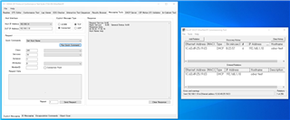

  • Hi Nilabh,
    I checked using the Rockwell EtherNet/IP Address Commissioning Tool, CT20, and Windows DHCP server, and in all cases the following object stored "lwip":
    "TCP/IP Interface Object - Instance 1 - Attribute 6: Host Name"
    I verified that the host name was set on each DHCP server, but it was not reflected in the object.
    When I checked the DHCP packet, I found that even if the host name was sent from the DHCP server in the DHCP Offe packet, "lwip" was stored in the host name in the DHCP Request packet from the AM243x.
    ct20_dhcp_packets.zip
    Therefore, we were able to confirm that the host name was not updated using DHCP in the first place.
