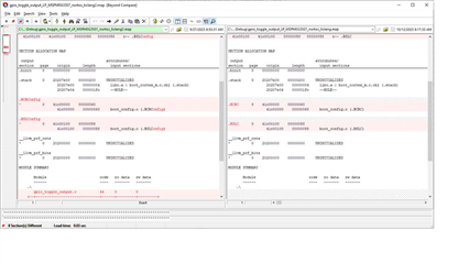

I have a question about the map file generated by a sample project.
Can you tell me what the * indicates at the beginning of some of these rows?

Hi Mari,
The '*' appear because the section name is too long. In this example, renaming the section with only 8 chars does not generate the '*'
