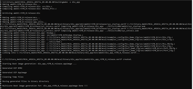

Hi Team,
We are using AM263x_09_00_01_00.
When compiled, Dio_Priv.c throws compilation error as follows.
for the Dio_GPIOPortAddr array definition STATIC is unknown type.
Could you please look into this?

    I just built DIO app example, there is no problem:
    I also built all the MCAL drivers, didn't see any issue:
    gmake -s all
