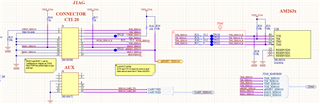

I have a new board that I am trying to bring up using the XDS110 Debug Probe.
I have the following connections and unable to get the Sitara to communicate over the UART interface when the Sitara is set in UART mode. UART pints are routed to UART0 A7/A6 balls.
My first thoughts are does the Sitara need to be flashed over JTAG or configured in any way before it will start to talk in UART or should I see the "cccc" being printed out of the box? JTAG seems to be working fine I was able to load code using the Dev Boot Mode.
    It is correct. The UART0 (A7, A6) is used for UART boot. ROM Code configures the UART0 to 115200 kbaud, 8-n-1 mode.
    How are the boot mode pins set on your board? For UART boot mode, the pin mapping is [SOP3,SOP2, SOP1, SOP0]=[0, 0, 0, 1]

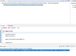

  • Can you run an example to see if the debug information can be printed out on UART terminal?
  • 1. I get the following in the consul when uploading the program to the chip

    2. When trying to run the program I see this message in the Console and the program doesn't run.
    I have had the program run and got this message in the Serial Terminal. I can't get it to happen again.

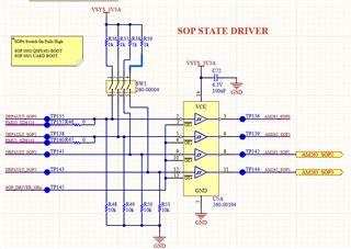

  • I think my problem is related to Boot Mode and SOP 2 and 3 being "Stuck" High.
    The Console out put shows this Line
    Cortex_R5_0: GEL Output: SOP MODE = 0x0000000D
    I have tried messing with the SOP setting and this is the output from
    SOP       GEL Output
    3 2 1 0    x b b b b
    1 0 0 1    D 1 1 0 1
    0 0 0 1    D 1 1 0 1
    0 0 0 0    C 1 1 0 0
    0 0 1 1    F 1 1 1 1
    1 1 0 0    C 1 1 0 0
    This is how it is wired and is the same as LP dev kit
  • Did you get a faulty switch (SW1)? Did you probe the voltage level of SOP2 and SPO3 pins?
  • I probed the signal and get 0V on the switch input I even shorted the ball directly to ground by connecting the AM263x side of the 10k Ohm resistor directly to ground through a PORz reset and still couldn't change the state.
  • You connect one pad of R12 and R13 to GND, but you still get wrong SOP GEL output. I checked the ball numbers in your schematics, they are correct (A11, C10). Have you tried another board?
  • Yes R12 and R13 to ground and it doesn't change the GEL output. I tried 2 in the office yesterday. I am working from home today and just have the one with me.
  • Please try another board next Monday. I'd like to know what causes this issue. Be careful when you connect a pin/ball to GND directly. It may damage your board if the pin or ball is shorted to VCC on your board.
  • Hi QJ,
    I got to the root of the issue. SOP2 and SOP3 lines are repurposed to the SPI lines that I had been externally pulling high one I de-populated those pull ups the chip botted in UART mode. This seems to a hardware issue on my side but thanks for all the help.
