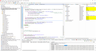

I am able to program the flash in Bank0 and in Bank1 and the EEPROM, but have not been able to program the OTP.   Which bank do i need to enable, 0, 1, or 7 (none of which seem related)?  Do I need to enable some sectors or is it enough to use Fapi_enableBanksForOtpWrite? I have not found an example that actually programs the OTP.  I there an example out there?
