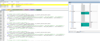

       I'm using the MSPM0G3507 evaluation board,I used ADC conversion and DMA output,I also want to use internal flash to store the variables I want to store。Now I find that the data stored by DMA will update the data stored by internal flash, but they are stored by different variables, is there any way to solve it?

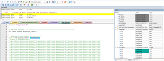

During the simulation, it is found that the data of SavedData changes with the change of RF_AD_Value data:
How can I solve it,Thanks。

    Please share the flash data of your MAIN_BASE_ADDRESS, does it change?
    Also, you can set the two avarible location away from the other, in case your pointer overflow and change the next variable.
    B.R.
    Sal
  • Hi
           I looked at the flash data of MAIN_BASE_ADDRESS, The data is unchanged。but the SavedData[0] and SavedData[1] Change in existence。I tried to change the number of DMA conversions to 2,and then the SavedData[0] and SavedData[1] don't change,but The chip will not be recognized the next time the program is burned, and the chip will need to be restarted to re-burn the program。Could it be a DMA configuration problem?Thanks。
  • Hi Lxy,
    Sorry for the late response. I missed your reply.
    .destWidth = DL_DMA_WIDTH_WORD,
    .srcWidth = DL_DMA_WIDTH_WORD,
    You set a word (4 bytes) for the DMA, but your destination is a 16-bit array, I thinks this is the problem.
    B.R.
    Sal
