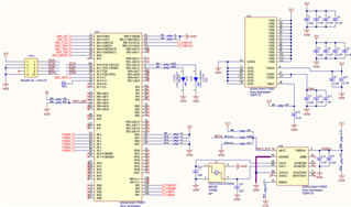

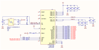

I copied XDS110 schematics in to my design to flash CC2652P7.
Reference schematics are taken from: MCU077A-LP-CC1352P7-4
I have problem with XDS110 section based on  MSP432E401YTPDT.

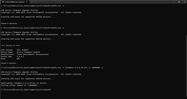

Now,  i can see
-------Terminal screenshot------------------------------------------------------------------
C:\ti\ccs_base\common\uscif\xds110>xdsdfu -e
USB Device Firmware Upgrade Utility
Copyright (c) 2008-2019 Texas Instruments Incorporated.  All rights reserved.
Scanning USB buses for supported XDS110 devices...
<<<< Device 0 >>>>
VID: 0x1cbe    PID: 0x00ff
Device Name:   Device Firmware Update
Manufacturer:  Texas Instruments Incorporated
Serial Num:    1.0.0.1
Mode:          DFU
Found 1 device.
Always in DFU mode.
From here, i could not reset

Later i flashed the device firmware using USB with the below command
C:\ti\ccs_base\common\uscif\xds110>xdsdfu.exe -f firmware_3.0.0.13.bin -r
Downloading firmware_3.0.0.13.bin to device...

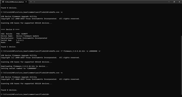

i removed USB cable and reconnected the port,
Now i don't see any USB devices
Found 0 devices.
Please help me in solving this issue.
