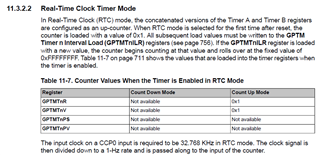

      I'm not sure about your application. I will suggest you use RTC (Real-Time Counter) to count real time based on a a 32.768kHz oscillator. Take a look at C:\ti\TivaWare_C_Series-2.2.0.295\examples\boards\ek-tm4c123gxl\hibernate.
    Other options include the Timer Module. You could use Timer Module with RTC as the input clock for time keeping too. Please refer to the datasheet for details.

    I have read the "7.3.5.1 RTC Counter - Seconds/Subseconds Mode" chapter in the datasheet.
    Would it be safe to say I can get a 15bit counter with subsecond precision if I use RTC?
    It seems that by reading HIBRTCSS I can get the subsecond value, and use this as a timestamp.
    And it says "A write to the HIBRTCLD register clears the 15-bit sub-seconds counter field" so I can use this to reset the counter, but only to 15bit precision. Are these correct?
    C.
      Yes, you can use the Hibernate module for subsection precision.
