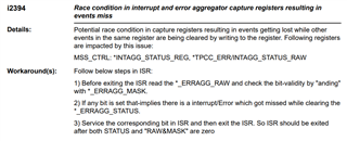

In errata notes, there is an advisory about interrupt event missing:
I want to check with you:
1). I can't find register MSS_CTRL: *INTAGG_STATUS_REG, *TPCC_ERR/INTAGG_STATUS_RAW in Register Addendum. Please clarify the registers with this issue.
    I can understand the confusion on this, we could be more descript about it. The registers in question are MSS_CTRL_TPCC0_INTAGG_STATUS, MSS_CTRL_TPCC0_ERRAGG_STATUS_RAW, and MSS_CTRL_TPCC0_INTAGG_STATUS_RAW

  • Hi Will,
    This workaround has not been implemented in SDK yet and will be added for upcoming SDK 9.1 release. Below JIRA tracks the same:
    [MCUSDK-12129] Open EDMA Errata i2394 - Texas Instruments JIRA (ti.com)
