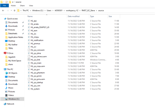

Is there any way to change the output folder for generated files on HALCOGEN?
Is there any way the generated files can be sorted in folder such as HALCOGEN device Explorer?

You can change the folder for entire project, but it is not possible to create each peripheral in different folders using HALCoGen. I mean the HALCoGen can only generate all the .c files in one folder called Source and all the .h files in another folder called include.
