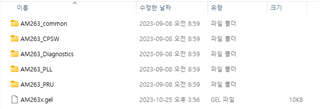

    Where as in JTAG it will be whatever order you manually load the .outs. Another possibility is the usage of GEL files to enable peripherals. When you use JTAG, are there any GEL files being run?
    Anand Mahadevan SS
  • Hi, Anand Mahadevan SS
    We also load in JTAG in this order.
    R5FSS0_1-> R5FSS0_0.
    When we use JTAG, Gel files we use are these.
