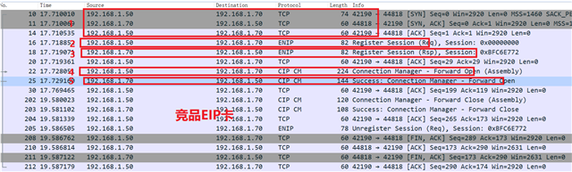

When customer use the modified eds files, and run EIP demo again, they use wireShark to say "connection failure" below:
Customer also use the same modified eds files to compared competitors MD500P_EIP and LP-AM243.
-MD500P_EIP
-LP-AM243
The customer capture the Wireshark on LP-AM243 below.

You can fine the below picture, when the PLC scanner sent the step4 data- forward open request, the MD500P_EIP can response the ”success:connection manager“, but our LP-AM243 response the ”connection failure“. So it stuck at Step 5 forward open response. We want to know how to modify the EIP demo code? Or Any suggestion here? Thanks.
