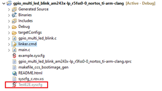

  • Hi Andrew,
    So to answer the original question at hand here, you can have multiple SysConfig files associated with a specific project as long as you only have one 'included' at a time. The other SysConfig files that are not being used for the build must be 'excluded' by right clicking and selecting "Exlcude from Build'
    When done it should look like this:
