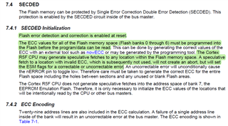

Could you provide an example on how to catch ECC flash errors on the RM57x?
Do I have to use EPC?

The RM57L843 microcontrollers protect all accesses to the on-chip flash memory and SRAM memory by dedicated Single-Error-Correction-Double-Error-Detection (SECDED) logic. The SECDED logic implementations use ECC for correcting single-bit errors and for detecting multiple-bit errors in the values read from the Flash or SRAM. The SECDED logic inside the CPU enabled by default after RESET.
So, any read by CPU to invalid ECC location will cause ESM flags to be SET.
So, we should just need to monitor the corresponding ESM flags to find out the ECC errors.
ESM 1.4 (1-bit ECC error) or ESM 2.3 (2-bit ECC error).

I am a little bit confused because:
a/ the first referred post says: "Uncorrectable ECC errors in reading Flash or RAM will only set ESM2.3.
b/ the second referred post says: "ESM 1.4 and ESM 2.21 are EPC correctable and uncorrectable errors."
c/ and your post says: “ESM 1.4 (1-bit ECC error) or ESM 2.3 (2-bit ECC error).”
I've built a test project with ESM 1.4 enabled. Group 2 does not need to be enabled. Flashed a binary without ECC in the LaunchPad. Run it with the emulator. And do not the flash ECC error. The project is attached. What is missing?
Any news about this issue? I haven´t succeed to make the flash ECC generate an error exception (any one).
Marcio
I've found this web page 7.1. Linker Generated ECC — Hercules Safety MCUs Documentation, which says CCS automatically adds ECC when downloading the binary to the MPU.
When I said that "I flashed a binary without ECC", I didn't realised that CCS had this option enabeld.
I was able to simulate a failure writing to a location outside the program boundary. ESM indicates channel 3 of group 2.
