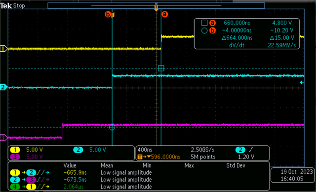

Hi Team,
There's an issue from the customer need your help:
we use 3 LP-AM243 in a EtherCAT network to test DC Sync0 signal, from the oscilloscope the sync0 signal have a large difference and more than 600ns.
Is it normal in PRU-ICSS?? thank you
