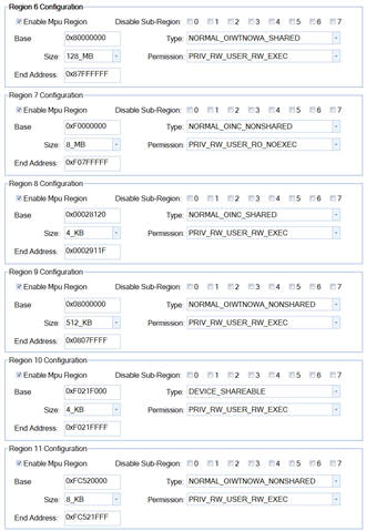

I am working with ethernet on the TMS570LC4357 and I am trying to enable the cache, but have been running in to some issues. It seems that when the cache is enabled (which is needed in our system) the EMAC peripheral stops functioning properly. After doing some research I have come across threads suggesting changing the RAM & CPPI Memory Slave to be Write-Through/Non-Cacheable memory regions. I have tried this but have not had any success.
Attached is a picture of our current HALCOGEN settings as well as our HL_sys_mpu.asm file. I've tried looking for conflicts among the MPU regions which may be causing issues but could not locate any. I may be missing something though.
I have also tried implementing a cache invalidated upon RX / cache flush upon TX according to the following forum post unsuccessfully:
https://e2e.ti.com/support/microcontrollers/arm-based-microcontrollers-group/arm-based-microcontrollers/f/arm-based-microcontrollers-forum/454291/how-to-flush-tms570lc4357-data-cache-before-emac-dma-transfer?ReplyFilter=Answers&ReplySortBy=Answers&ReplySortOrder=Descending
But did not have any success with this as I was getting an error in regards to the BLO instruction saying it is an undefined symbol.
Any insight would be greatly appreciated.

  • Hello Thomas,
    Our expert for this topic is out on local holiday and will be back on Wednesday, please wait for their feedback until then, thank you.
    Ralph Jacobi
  • Hi Thomas Hickey,
    On your settings i can see your SRAM MPU setting is still not in write through.
    You will need to change the cache scheme from write-back to write-through. See below highlighted in yellow for write-through.
    Thanks & regards,
    Jagadish.
  • We are unable to change regions 1-4 due to having FreeRTOS enabled. If you look at the later sections that I posted we do change SRAM from write-back to write-through ( See our region 9 ). From my understanding higher numbered regions take take precedent over lower numbered regions and will overwrite their settings. If I am mistaken by this please correct me.
  • Hi Jagadish,
    I have created a small project that illustrates the issue that we are running in to and put it into a .zip file that I have attached to this comment. An explanation of the issue we are seeing follows. If you would be able to investigate it a little bit I would greatly appreciate it.
    When I have RAM set to write-through and I try to send out a message directly from main() via EMACTransmit() it works just fine, but if I put that same code in to a task I suddenly see that all 0's are being transmitted. The toggle between sending the message out directly in main versus from a task can be triggered with the macro EN_TASKS towards the top of the main.c file. ( setting it 0 sends the message out from main(), setting it to 1 sends out the message from within a task context).
    If you have any clue as to why this may be happening it would be greatly appreciated as it would give great insight as to what is causing this issue in our actual application.
    7801.EMACTest_RTOS_2.zip
  • Hi Thomas,
    Thanks for providing the code and i will go through it soon, it might take some delay as i stuck with other issues as well.
    Thanks & regards,
    Jagadish.
  • Hi Jadadish,
    We were able to make some progress on the issue. In the example project I provided we were able to get EMACTransmit() to run from within a task context by setting the port privilege bit in uxPriority of xTaskCreateStatic(). We tried porting this solution over to our main application, and while it resolves the issue it also has introduced some instability to our system.
    I found this forum post: https://e2e.ti.com/support/microcontrollers/arm-based-microcontrollers-group/arm-based-microcontrollers/f/arm-based-microcontrollers-forum/1158788/faq-tms570lc4357-how-to-solve-the-cache-coherency-issues-when-accessing-the-shared-memory-through-cpu-and-dma
    in regards to DMA transfers & cache coherency. I am a bit confused on how to integrate this in to our project though and was hoping you might be able to help us out. In the mini-project that I created and attached to my previous comment I was curious as to how I would properly use
    coreInvalidateDCByAddress(uint32 u32Address, uint32 u32Size)
    within EMACReceive() and how I would use
    coreCleanDCByAddress(uint32 u32Address, uint32 u32Size);
    within EMACTransmit()
    ie: where within EMACReceive/EMACTransmit would I call those functions and what should I be passing as the parameters? I am a bit confused by the usage so some help would be greatly appreciated.
    Other than that if you come up with a solution to the original issue that does not involve using these cacheClean/cacheInvalidate functions, but rather solve this issue using the MPU please let me know.
    Thank you,
    Thomas Hickey
