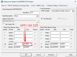

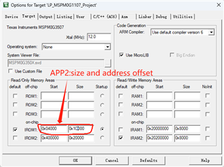

I using MSPM0G3507 evaluation board. we plan to run APP1 in the first 16k space of the flash and APP2 in the back space. The customer has two questions:
1. How to jump between two APPs while they are running?like this:
This is the function of the jump:
void run_app(uint32 appxaddr)
//if (((*(vu32*)appxaddr) & 0x20000000 ) == 0x20000000)
//SCB->VTOR = (vu32)0x4000;
jump2app=(iapfun)*(vu32*)(appxaddr+4);
__set_MSP(*(vu32*)appxaddr);
//__disable_irq();
jump2app();
and interrupt vector table also need to make the corresponding offset:SCB->VTOR = FLASH_BASE | 0x10000;
2. Since APP2 does not start running FROM flash address 0, what modifications and settings need to be made to the compiler keil5 and APP2 codes? Can you provide these development materials or sample code?like this:
Thanks a lot!
    Please see the following E2E post for some answers to your question: https://e2e.ti.com/support/microcontrollers/arm-based-microcontrollers-group/arm-based-microcontrollers/f/arm-based-microcontrollers-forum/1279297/mspm0g1107-if-the-mcu-need-to-support-2-apps-how-to-realize-the-jump-between-the-two-apps-how-to-set-up-the-compiler-and-app-code
    You would for sure need to do interrupt vector forwarding and change that per application. That being said, we currently don't have example code/documentation on how to do this independently, but we do have two applications that include this feature on a secondary measure that you can utilize to accomplish your goal.
    First, is the Secondary BSL example, which places a customizable bootloader into application flash. In this instance the secondary BSL would be your APP1 and the loaded image would be your APP2. So you can look at the mechanisms in there to do what you need.
    BSL UG, Section 6 Secondary BSL
    The other option would be to look at our BIM (Boot Image Manager) implementation which  gives you exactly what you need, plus additional security features. You could potentially strip this down to something simpler to fit your needs.
    BIM Documentation
    BIM Example
