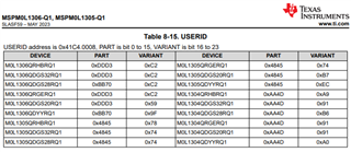

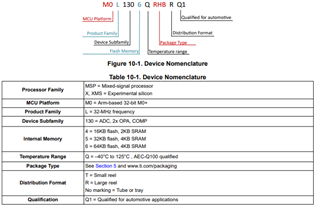

I recently got a few ICs, and the complete part number is MSPM0L1306QRHB.
But just when I try to read UserID. I found that the value read was different from what was written in the datasheet.
In UserID, the value of VARIANT can be read as 0xC2, but the value of PART is 0xDDD3.
PART should read 0xBB70.
Is there any reason for this problem? Is there any way to solve this problem?
