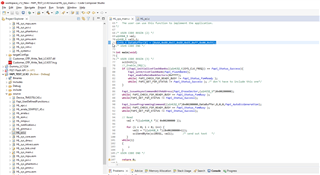

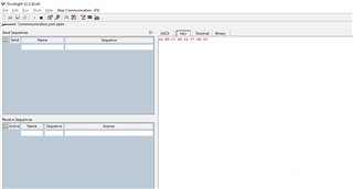

  • Hi Ben,
    I created one example project similar to the customer issue and i don't see any issue in reading.
    And the same data i am receiving on serial terminal as below:
    So, i am attaching my complete project here, can you please ask the customer to test it.
    7651.FAPI_TEST_LC43.zip
