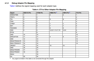

I was attempting to debug my AWR1843AOPEVM board using the XDS110 debug probe. However, when connecting the JTAG header of my AOP board to the XDS110 using the FRC cable and the connector provided with the debugger (pictures attached), I noticed that the JTAG TMS pin on the AOP board doesn't match the TMS pin on the connector.
In the image below, it appears that TMS should be accessible at the 1st pin. However, when using the provided connector, TMS is accessible from the 3rd pin.
Could you please provide the PCB layout of the connector (516441 Rev A)?
