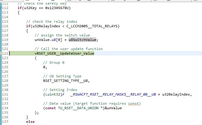

I had to debug an application because we determined a seemingly trivial function was not being called during some system level validation tests..
A image of my function call is shown below. I'm passing in a U32, U8, U32 and a pointer.

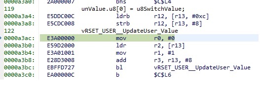

I also note the disassembly listing just just before the CPU should branch to my function

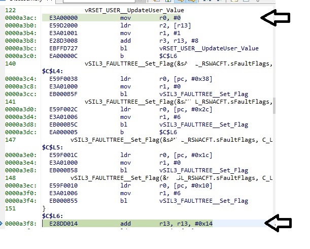

When I step in the C code window, the function does not get called and my cursor ends up at the end of the calling function:

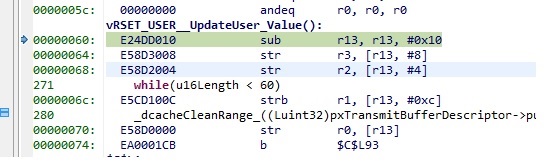

Interesting to note that the function in question seems to be the first function linked at FLASH address 0x60:

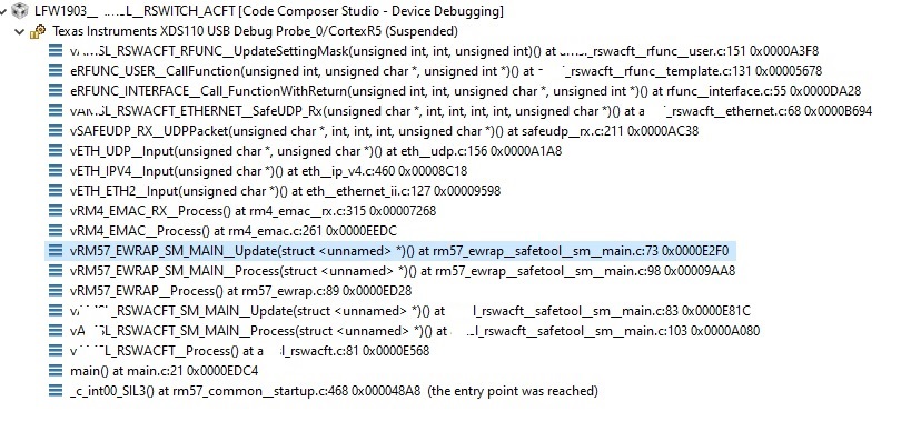

The calling function is entered after some lengthy stack calls, and I'm not sure if that is contributing to the issue, however other functions with the same calling method and call depth work just fine. (I don't think the call depth is too excessive)
When I step in the dissasembly window, using instruction stepping mode, the CPU will enter our function
But the actual code at that function is from another module (the code shown above is actually part of a ethernet driver), and as soon as I get into that target function it looks like the stack is gone or the CPU is lost.
The linker stack size is 0x3000 and the current stack pointer is at 0x080023D0, so I don't think we are seeing a stack overflow (and there is no reason either, we are not passing lots of memory between function calls). I am not in interrupt context, this is a mature code base, and the issue is repeatable.

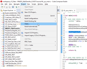

    I can just give you a shortcut to delete output folders in all the projects and rebuilt all the projects with one click.
    first step is you just need to import all the required projects in CCS.
    Second step is select the "clean" build option in CCS.
    Now click the check box of the "clean all projects".
    and click the "Clean" button now.
    What this option will do is, it will delete the debug output folders in the all the projects and projects will get rebuilt from the scratch.
