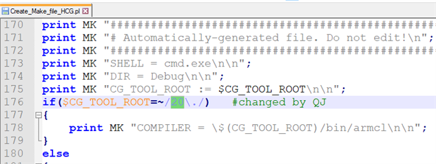

    But one change should be make in Creat_Make_file_HCG.pl: line 175, change 5 to 20

    [3] Modified -> Creat_Make_file_HCG.pl: line 175, change 5 to 20

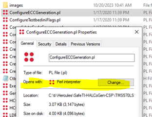

    Did you change the association to all the .pl files in scripts folder? I think you have set up your environment variables properly for perl.
  •  I changed the association, see the attached screen shot.
    1. When I double click on them, the cmd prompt flashes, indicating the perl script ran
    2. In another folder on my computer, I have a perl script that generates a debug bread crumb file. So I known for 100% that the association is set properly
    3. TAU no longer opens the scripts in the editor when run is clicked
