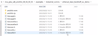

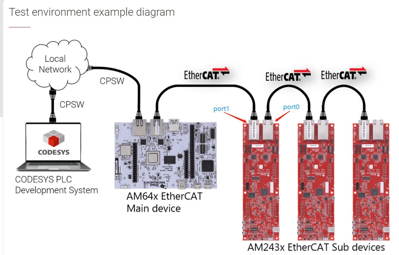

customer is evaluating our EtherCAT solution on LP-AM243. The environment is:
    EVM boards: LP-AM243
    CCS: 12.4.0
    SDK: mcu_plus_sdk_am243x_08_06_00_45
    SSC Tool: V5.13
    TwinCAT3

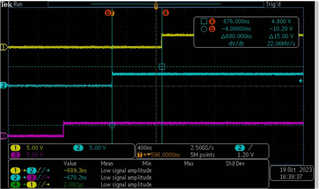

After setting TwinCAT master to DC sync mode, they measured 3 LP-AM243's DC sync output, and found the below SYNC OUT delay:
Please help analyzing this delay.
