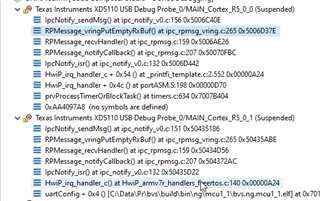

I changed our RPMessage-Ipc-Implementation from using a notify and then reading out the RPMessage-Buffer in a task context to an interrupt driven implementation which reads out the ipc-buffer as soon as the callback is called.
But here I faced two problems.
1.

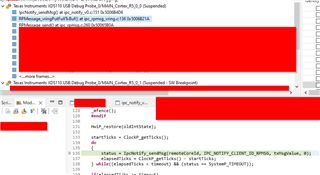

when using a RPMessage_send from both cores at nearly the same time window with a timeout of 0 it happens that one of the two cores (seems to be related which one is started first) returns with a timeout. This comes from the function RPMessage_vringGetEmptyTxBuf which returns SystemP_FAILURE, which is the internal branch of /* There's nothing available */. While the other one can send normally. If I raise the timeout to ten I can at least handle the first packages but then this happens at a later point:
2.

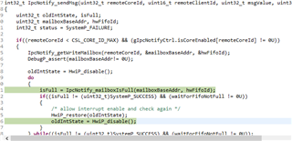

This seems to be really strange, when looking into the function it hangs inside a loop which it would never return following the logic since the mailboxIsFull stays 1 when both cores stay in this loop. And this happens inside working on the interrupt that is issued because the other core did send a telegram:

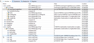

Those are the variables in this case for RPMessage:

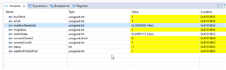

and for IpcNotify:

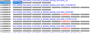

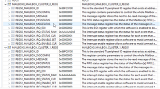

and a register snippet for the two cores for the mailbox-registers:
The MAILBOX-registers also show some more values in memory-view, not sure if this is important, since there are some bits set, not shown in the register-view:
This seems to be a deadlock-situation that happens when both cores send messages simultaeneously.
I changed to this implementation coming from the task-context-based-implementation, because it happened that one core was busy with other stuff while the other core already filled the vring-buffers and could not send anymore. I thought that may be a valid solution then but then those problems occured.
I will snip down to the sequences since there is some of our code around. Keep in mind we initialize the needed params with valid values in our own driver-implementation:

The callback gets called on the other core! So In my understanding it should use the packet, do its work inside the callback and then give the memory inside the buffer free again.
So I wouldn't see any problem having a whole interrupt-based solution since even if multiple cores are sending messages at the same time the RPMessage-implementation. But here it seems
we also ensured the interrupt-stacks have enough size:
Edit: Update:
I also tried inifite-timeout values the behaviour stays the same like in 2.
I also noticed that a warm reset does not reset the Ipc-related stuff correctly. I got this "hanging"-bug also at the IpcNotify_syncAll-function-call after a CPU-reset and load again of the images in CCS. Is this preventable? A clean reset would be a nice feature.
Setup:
We have a region in the linker defined for the IPC-shared memory. It start at 0x701D0000 in our case (IPC starts at 0x701D8000). The MPU is set accordingly to not cached but shared. We have our own IpcDriver but are using the RPMessage. We have ensured that the VRING is aallocated accordingly to what SysCfg would normally so. Without going too deep into detail: The whole situation once worked before without using the direct callbacks but the notify and then getting the packet in a task context. It first appeared as soon as I changed it to a direct callback.
Best regards
Felix
  • Hi Felix,
    Timeout implementation is missing when Notify_sendMsg() is called by RPMessage_send().
    Please replace the IPC RPMsg driver files (ipc_rpmsg.c, ipc_rpmsg_priv.h, ipc_rpmsg_vring.c), at "source/drivers/ipc_rpmsg" with below files.
    Can you check if this update helps to resolve the issue?

  • Hello Ashwin,
    thanks for this proposal but unfortunately it does not seem to change the "deadlock" that both cores run into. So the case for the second situation is still the same.
    I do not understand the drivers completely but it seems that the RPMessage_vringPutEmptyRxBuf-function sets the value RPMESSAGE_MSG_VRING_NEW_EMPTY to be transmitted. But this value is never used anywhere else. But I do not think that's the main-problem since it seems to be an IPC-Mailbox-problem, since it's stuck in the loop when the mailbox is full but it's waiting for them to get "not full". I would've not expect for it to get full. Allthough the problem occurs even in the callback for the RPMessage where it was already handled and IPC should be free then. I guess it's on purpose to send this IpcNotify-Message with the value of RPMESSAGE_MSG_VRING_NEW_EMPTY even if it is never used inside the the callback for receiving of RPMessages?
    Best regards
    Felix
  • Hello Ashwin, another update:
    I removed the IpcNotify_sendMessage call inside RPMessage_vringPutEmptyRxBuf since I did not see any use of it at the remote cores (in your updated files line 272-276) . After removing everything seems to work fine. But I am not sure about this.
  • Hi Felix,
     IpcNotify_sendMessage call inside RPMessage_vringPutEmptyRxBuf is mandatory since that is how we notify the sender core that a VRING buffer has been freed and if any message is pending transmission, it can be sent out.
    Can you let me know how to create a sample application to recreate this scenario? I can try to debug further on my side.
    Ashwin
  • Hey Ashwin, that's what I also thought but where is this happening? I cannot see the answer is used anywhere inside the RPMessage. But maybe I am just not finding it.
    Since we are using a more complex system it is maybe not easy to recreate the same scenario. But we set up the following: RPMessage with 8 Buffers with each 512 Byte which uses the recvCallBack (not the notify) with an argument ( a this-pointer for a c++-object which holds the callback to be called in the end as a member-function) on two cores. After an IpcNotify-Sync you just start sending telegrams from each core. Maybe up to twenty (I didn't count after how many this occured). And then it should occur.
    Edit: I just noticed I didn't mention something that may be an issue here: inside a recvCallback we may also call an RPMessage send! That's like one core requests something and the confirmation is sent inside the callback. Not sure if this can also have an impact to this behaviour.
    Thanks for your effort!
    Anyway: Now that I removed this one IpcNotify_sendMsg, why does it work? we do not lose any packets and everything seems to work just fine. I would've expected that a message will pop up that a message can't be posted tot the VRING-buffer or anything, but nothing shows up.
    Best regards
    Felix
  • Hi Felix,
    RecvCallback() get executed within ISR context and RPMessage_send() should not be called from within an ISR. This is because RPMessage_send() uses ClockP API's which can cause a deadlock during timeout measurement. Can you try doing a semaphore post from the RecvCallback() API which unhalts another task which will do the RPMessageSend() ?
    Ashwin
  • hey Ashwin,
    ok! That sounds understandable. I would recommend adding this to the documentation. I will try to figure out how we can insert a receiver-task, since it means some structural change and probably some priority interferring with our startup-task. But I will test and keep you updated.
    Felix
  • Sure Felix, I'll take an action to update the documentation. Do keep me posted.
    Ashwin
  • Hes Ashwin,
    so I managed to create a sender-task. This one buffers our send-requests.
    This means in case the remote core sends a telegram the local core will not send that answer inside the interrupt-callback but will buffer it to the sender-task. The sender-task is just using a semaphore to get informed for new packages in the buffer and sends them out.
    There is a small problem since our init-task has the highest priority. this is also the task sending any requests (not answers to requests). The sender-task also got the highest priority. the init task won't use the sender-task and send out telegrams directly. Otherwise if inside an interrupt an answer is generated it gets put to a sender-task. Now which one proceeds? If the init-task still does some more requests the remote core will generate 8 answers for 8 interrupts and put them into the sender-buffer (which is 8 elements big).
    I know this is hard to think about without getting a brain shock since I cannot really reconstruct the situation myself.
    But continuing this situation it seems to happen that one core runs into

    I tried calling a reset-routine for the reset-registers of all- Mailboxes like it is described in the TRM always if I start from core 0_0. but unfortunatley this does not help.
    I did it like this (a bit dirty, yeah.. but I see the regiters get reset in the register view)
        if( selfCore->getCoreId() == CSL_CORE_ID_R5FSS0_0 )
            /* reset IPC MAILBOX-registers */
            for(uint32_t i=0; gIpcNotifyMailboxBaseAddr[i]!=0U; i++)
                volatile uint32_t* mailboxPtr =
                reinterpret_cast<volatile uint32_t*>(gIpcNotifyMailboxBaseAddr[i]);
                mailboxPtr += 4; // get to SysCfg-register
                *mailboxPtr = 0x00000001;
                while ((*mailboxPtr & 0x00000001) != 0)
            interruptConfigGb = &gIpcNotifyInterruptConfig_r5fss0_0[0];
            interruptConfigNumGb = gIpcNotifyInterruptConfigNum_r5fss0_0;
    Also this is only for debugging. How can I make sure that the IPC MAILBOX registers get reset correctly? Currently it doesn't seem to work with the reset-registers.

    I start with 3:
    So after a reset at startup it looks like this:
    so I thought that should happen, but as soon as it once runs into Mailbox full It will be there even if I start core 1 again with the reset-mechanic. If I understand it right, this flag here tells us it's full:
    core 1 is then stuck here even after the reset-call:
    I need to repower the device to get it working again. But as we see the registers are reset before so I don't get what's going on here. Could it be the fifos are not really reset?
