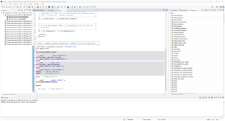

The OSPI sample source in the SDK does not work.
How do I get the OSPI sample source to work?
【Supplementary Information】
     SDK                    :mcu_plus_sdk_am243x_09_00_00_30
     SysConfig           :sysconfig_1.17.0
     Sample Source   :ospi_flash_io_am243x-evm_r5fss0-0_nortos_ti-arm-clang
     Evaluation Board:TMDS243EVM
     Unclear point      :A long time loop is executed in the while statement of the Flash_norOspiWaitReady function in flash_nor_ospi.c.

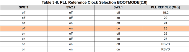

    • What is the current PLL settings based on the position of the SW2.[3:1] switches on the board?

    "What is the current PLL settings based on the position of the SW2.[3:1] switches on the board? "
      PLL REF CLK is set to 25MHz.
