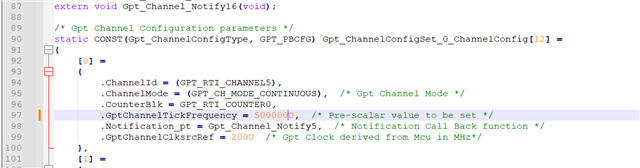

I am using this configuration:
But the timer interrupt fires every 0.000223 seconds.

In order to configure 5ms,
Clock frequency is taken as 200MHz and the preload value as 1 which defines,
Tick frequency as (Clock frequency/ (1+Preload value))
So, tick frequency becomes 200MHz/ (1+1) = 200MHZ/2 = 100MHz = 10nanoseconds
So, to fire timer interrupt every 5 ms, timer should count up to 5ms/10ns, i.e.,500000 times.
Thanks for your help, what is the register to put the 500000 value inside?
You can put it in tick frequency section in your configuration. Below i have provide a sample reference through which you can predict.
I don't want to use the GPT, I want to user the timer peripheral direct.
If you want under timer peripherals, then under compare upcounter assign 500000 and free running counter shall be 1.
you can find user guide here 4.12. GPT — Platform MCAL Development - AM263 User Guide (ti.com)
I used the suggested value by your side and still not working every 5 ms

I tried to configure it here
But it was not working as expected.
Thanks for your help.
Hi Afifi,
Unfortunately, MCAL does not have register level api's to use timer module as it is not in the scope.
Can you refer below documentation in SDK and build this example?
software-dl.ti.com/.../EXAMPLES_DRIVERS_RTI_LED_BLINK.html
Please refer "Drivers_rtiOpen" api in generated\ti_drivers_open_close.c which has register level api's to configure timer.
