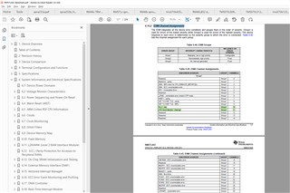

  • Hi Marcio,
    We just need to verify the TRM and datasheet combinedly to find out the bit number in ESM registers.
    For example:
    In TRM, at below section they clearly mention the ESM registers and corresponding ESM channel bits.
    So according to above section:
    1. ESMILSR1[31:0], ESMILCR1[31:0] and ESMSR1[31:0] will be used for Group1(Chennel 31:0).
    That means bit-0 is for Group1 channel-0 and bit-1 for the Group1 channel-1 and so on.
    2. ESMIEPSR4[31:0], ESMIEPCR4[31:0], ESMIESR4[31:0], ESMIECR4[31:0], ESMILSR4[31:0], ESMILCR4[31:0] and ESMSR4[31:0] will be used for Group1(Chennel 32:63).
    That means bit-0 is for Group1 channel-32 and bit-1 for the Group1 channel-33 and so on.
    3. ESMIEPSR7[31:0], ESMIEPCR7[31:0], ESMIESR7[31:0], ESMIECR7[31:0], ESMILSR7[31:0], ESMILCR7[31:0] and ESMSR7[31:0] will be used for Group1(Chennel 64:95).
    That means bit-0 is for Group1 channel-64 and bit-1 for the Group1 channel-65 and so on.
    4. ESMSR2[31:0] will be used for Group2(Chennel 31:0).
    That means bit-0 is for Group2 channel-0 and bit-1 for the Group2 channel-1 and so on.
    5. ESMSR3[31:0] will be used for Group3(Chennel 31:0).
    That means bit-0 is for Group3 channel-0 and bit-1 for the Group3 channel-1 and so on.
    So now to find out what is each channel significance, we have to refer the datasheet ESM Channel Assignments section:

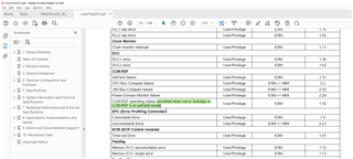

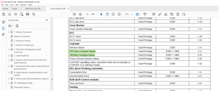

  • Hi Marcio,
    Is the following indication is set during normal operation or only when performing the diagnostic of the detection mechanisms?
    Group 1 - Channel 31: CCMR5F - CPU Compare Self-Test Error
    The CPU compare error primarily asserts either CPU Bus Compare failure or VIM Bus Compare failure depends on the error.
    But it is also asserts the "Self-test failure", see the below note in TRM.
    But the main purpose of the "Self-test failure error" flag is different, it is used to detect the fault inside the CCM module itself.
    Group 1 - Channel 92: CCMR5F - Operating Status
    This is not an error, this is just like status flag like as mentioned in the datasheet:
    This flag will get set while either CPU's are not in lockstep or self-test mode is running. CPU's not in lockstep condition will not possible because CPU's are always operate in lockstep mode only. The right possible way is self-test mode running.
