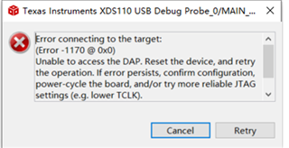

MCU-PLUS-SDK-AM243X: AM243x EVM Report Error connecting to the target: Error -1170@0x0 Unable to access the DAP
Part Number: MCU-PLUS-SDK-AM243X
Hi Ti team
         I am using SDK_09_00_00_35/examples/drivers/ipc/ipc_rpmsg_echo on AM243x EVM board
         I have modified default_sbl_ospi_multi_partition.cfg and flash all appimage.hs_fs to the borad.
         I also make sure that Target Configuration has been modified to multi-core mode.
         But, when I try to connect R5_1_0, the following error is always reported. while R5_0_0 and R5_0_1 can be connected.
         Could you tell me how to run the multi-core on my AM243x EVM?
          or where can i get a detailed guidance?
Thansk
Chunyang
  • Hello Chunyang,
    Can you please include the modified cfg file or describe how it was changed?
    Can you try using the "test connection" button on the target configuration (<name>.ccxml) file to confirm that the entire JTAG scan test has no failures?
    Erik
