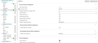

  • Hello Frank:
    1. About the "Sleep Mode":
    You can configurate the "Low Power Policy" of "Power & Systems Configuration" on Syscfg—SYSCTL. You can select "Sleep 0", "Sleep 1" and "Sleep 2" according to your requirement. The Difference of SLEEP mode can be found in "Table 2-1. MSPM0Lxx Supported Functionality by Operation Mode" of MSPM0 L-Series Technical Reference Manual.
    And then you can use the "_WFI();" instruction in your main function. The device will be in sleep mode until an external interrupt generated.
    2. About the "wake up":
    We have example code about input signal capturing which can detect the duty cycle and period of input PWM. You can find the "timx_timer_mode_capture_duty_and period" project in our SDK on Ti.com.
    When the device detects the Status 1 signal and Status 2 signal in the interrupt handling function, you can set the CPU to sleep mode again. And when the device detects the Status 3 signal and Status 3 signal in the interrupt handling function, you can wake up the CPU.
    For example, you can use a flag in the while loop in main function. When the device detects the Status 1 signal and Status 2 signal, the flag is set to false, and when the device detects the Status 3 signal and Status 4 signal, the flag is set to true.
