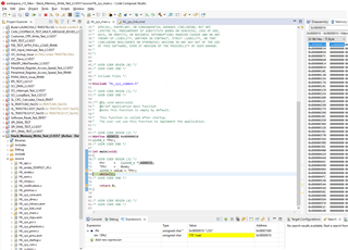

Dear TI support,
is it possible to write at specific address of STACK memory area and read that back periodically during runtime?

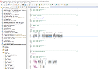

Hi Manoraj Selvaraj,
You can do that, you just need to declare a pointer with pointing the corresponding stack address.
For example:
As you can see the stack is started from the address 0x08000000.
So, i just write a program like below to access one address in the stack.
In this way you can do it.
I am attaching my project for your reference:
Stack_Memory_Write_Test_LC4357.zip
