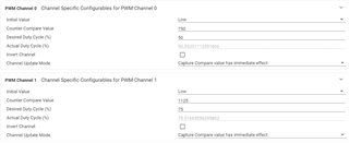

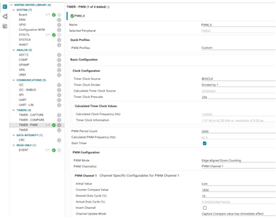

I am trying to create a pwm signal based on timer by configuring in the sysconfig file.
I have also tried to run example projects such as -
1. Arm-based microcontrollers/Embedded Software/MSPM0 SDK/Examples/Development Tools/LP-MPM0L1306 LaunchPad /DriverLib/ timx_timer_mode_pwm_edge_sleep
2. Arm-based microcontrollers/Embedded Software/MSPM0 SDK/Examples/Development Tools/LP-MPM0L1306 LaunchPad /DriverLib/ timx_timer_mode_pwm_edge_sleep_shadow
3. Arm-based microcontrollers/Embedded Software/MSPM0 SDK/Examples/Development Tools/LP-MPM0L1306 LaunchPad / MSP Subsystems / pwm_led_driver
I have verified the launchpad jumper connections as well. I have tried to generate pwm in PA12, PA13 pins. I have used the internal XDS110 in the launchpad as well as I have used an external XDS110 debugger after removing the SWDIO and SWCLK jumpers
I have attached the sysconfig screenshots here.Please let me know if I am missing something

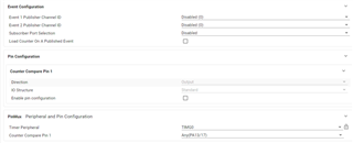

    There three points you need to notice:
    1). Our each TIMG x has two PWM channels, and you can determine which channels are in use.
    if you can accept using the same clock source to generate two PWM waves, you can choose to use TIMG0 to generate two PWM on PA12 and PA13. The following figure is an example.
    2). If you need to generate two PWM using different clock source, you can choose to use different TIMER.
    3). Please make sure that the PWM channel and the Counter Compare Pin which you chose are corresponding.
    4). You don't need to click the "Start Timer" in the Syscfg. You can use the "DL_TimerG_startCounter(PWM_0_INST); " in your program to control the TIMER to generate PWM when you need.

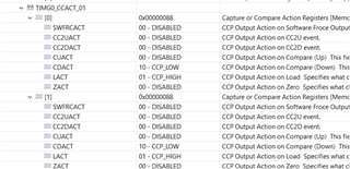

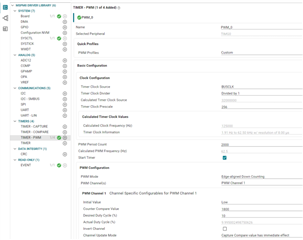

    I have ensured all the above points and have tested it with generating 2 PWM signals on PA12 and PA13 with the same clock but was unable to generate PWM signals.
    I also tried to generate single PWMs in both PA12 and PA13 separately and ensured the counter compare pin is selected with the respective TIMG0 and still couldn't generate PWM.I have also used DL_TimerG_startCounter(PWM_0_INST).. I can see the Timer running and CCD event occurring but unable to get PWM as outputs.
