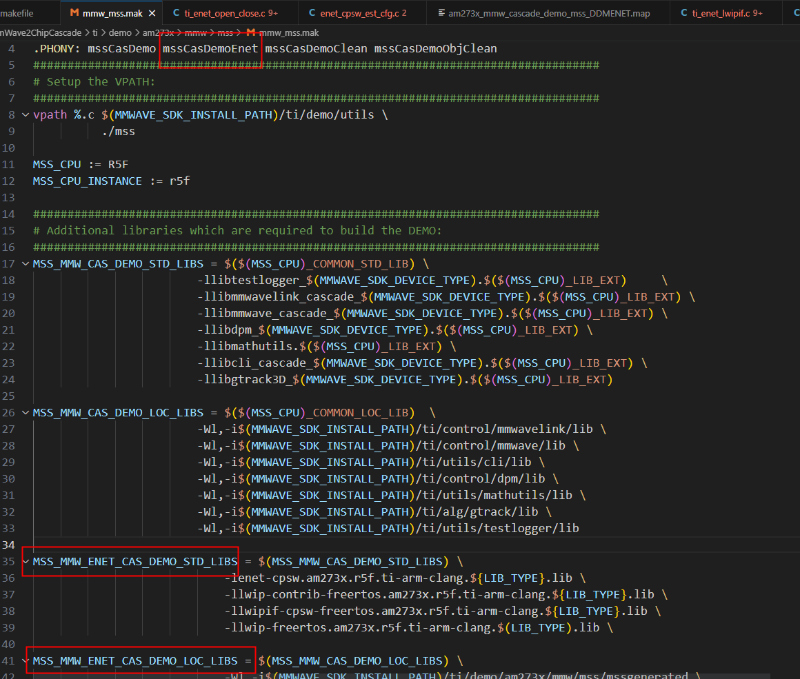

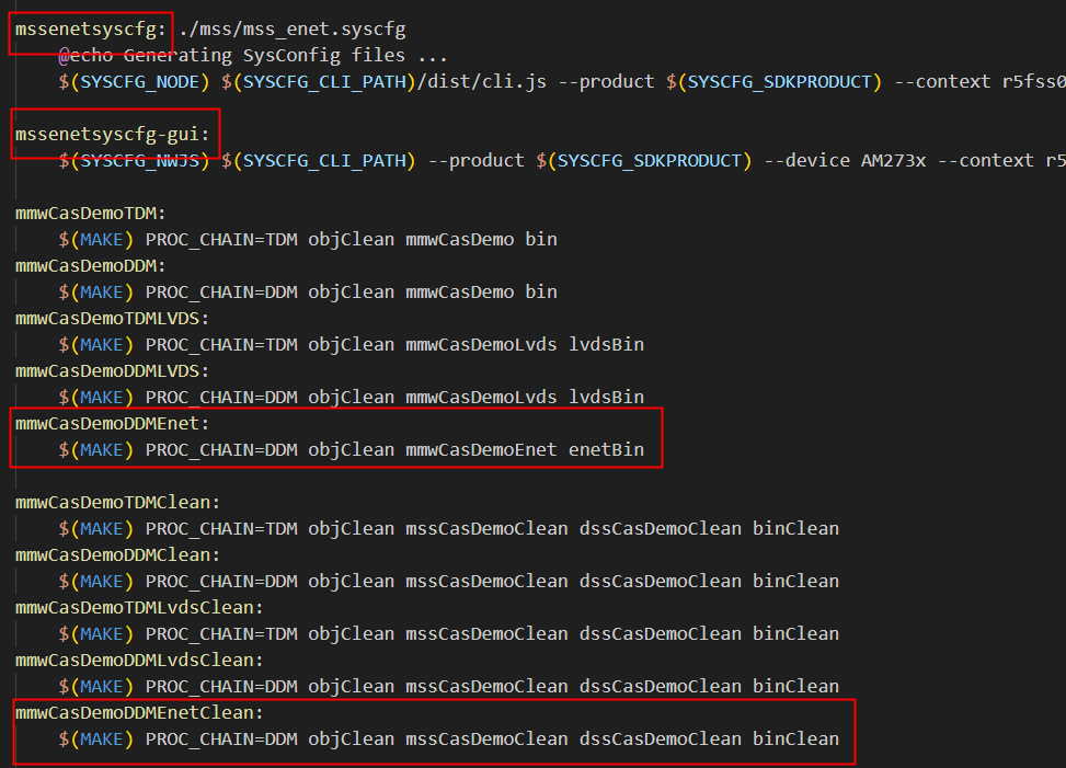

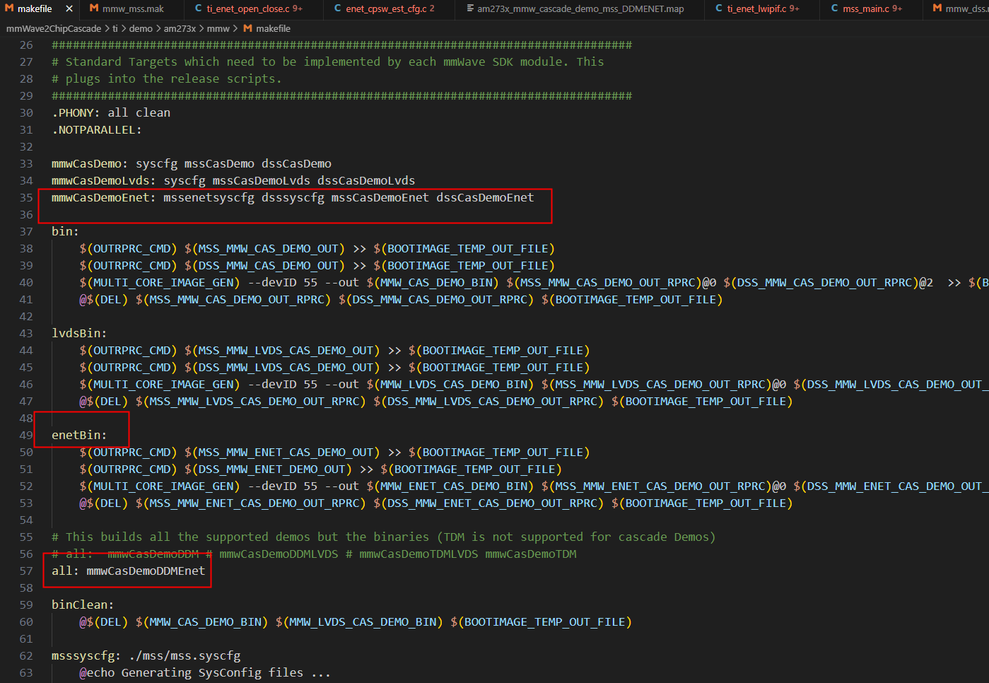

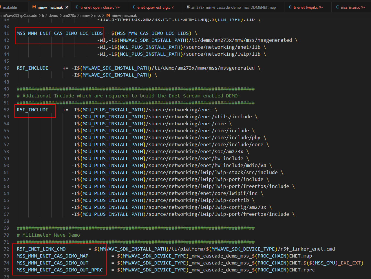

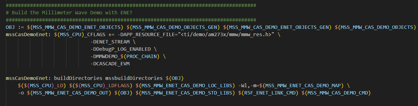

The SDK used is mmWave2ChipCascade. Mainly modified the makefile and .\mms\mmw_mss.mak file under mmWave2ChipCascade\ti\demo\am273x\mmw\ as follows:

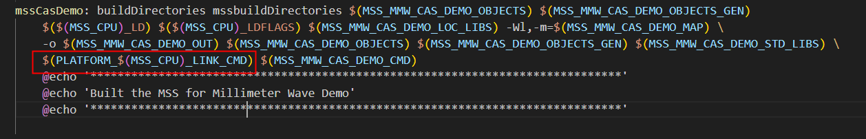

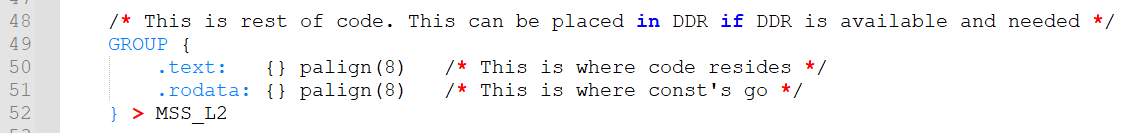

And the customer modified the path to cmd file called in mmw_mss.Mak file, changed from calling r5f_linker.cmd to call r5f_linker.cmd:

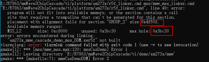

For now the error being reported is as follows:

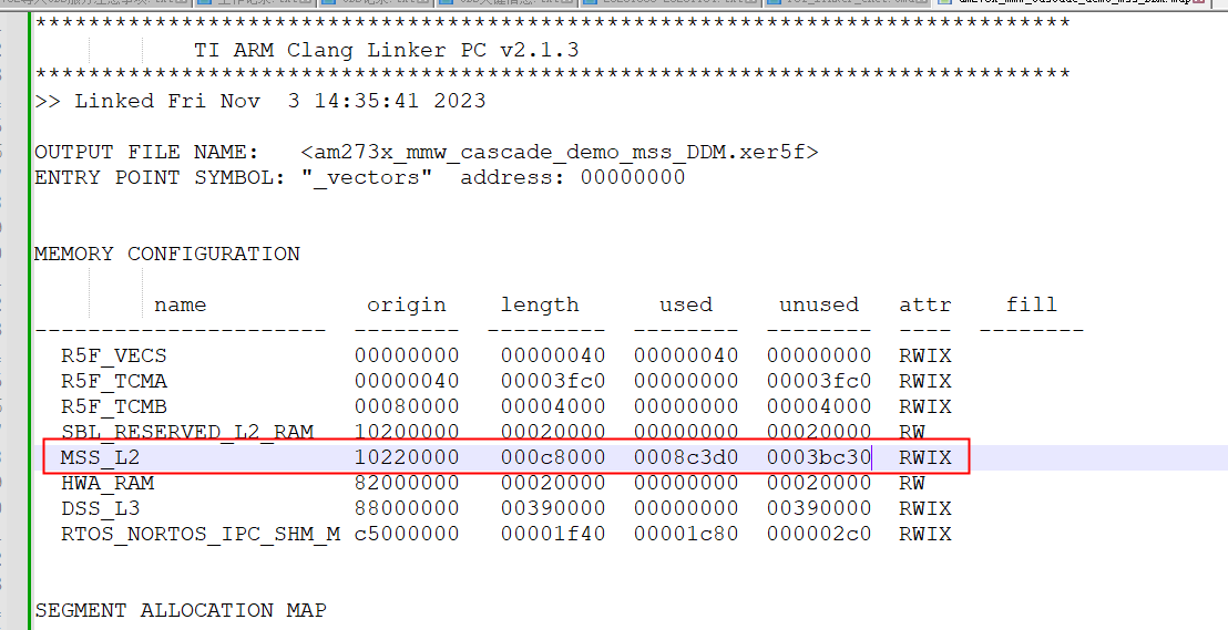

The current remaining space can also be seen in the map file:
The customer would like to know how to modify the cmd file?
