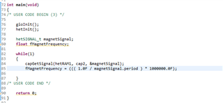

We test codes is this:
Thanks.

  • Hi Jagadish,
    We founded a temporary solution for this but We are not sure that it will work reliable.
    Can you control this code. We revised capGetSignal function with this (shift right 7 changed to 0)
    void capGetSignal(hetRAMBASE_t * hetRAM, uint32 cap, hetSIGNAL_t *signal)
        uint32    pwmDuty   = (hetRAM->Instruction[(cap << 1U) + 25U].Data) >> 7U;
        uint32    pwmPeriod = (hetRAM->Instruction[(cap << 1U) + 26U].Data) >> 0U;
        signal->duty   = (pwmDuty * 100U) / pwmPeriod;
        signal->period = pwmPeriod;
    By followed, we got received frequency with this calculation :
    fFrequency = ( ( ( 1.0F / pwmperiod ) * 1000000.0F ) / 11.10F ) * 1000;
    I hope it helps you
    Thanks.
    Ali.

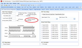

    Actually, i understood the real route cause for the problem. The problem is due to the large amount of LR (Loop Resolution) time.
    LR time in our case is equal to the 1.422uS. Actually, the values we are seeing are not wrong values, they are just expected values only.
    Here the period is measured by using loop resolutions, i mean for example if we need to measure a period between two raising edges then we will start increment a register value after first raising edge and we continue to increment the register value after each loop and this process will continue till other raising edge has been reached.
    Now the period = register_count (Number of loop resolutions) * One loop resolution Period.
    If you analyze above formula, there should be max of one loop resolution period error would be possible, I mean
    Measured_Period = (Actual_Period) to (Actual_Period + One_Loop_Resolution_period).
    For example, if you are trying to measure 120Khz frequency (8.33uS period) then imagine if your loop resolution is sampled at 8.29uS then it will again do the next sample at 8.29 + 1.422 to calculate the period.
    So, Measured_Period = 8.33 to (8.33 + 1.422)
    So, the measured value can be anywhere in between 8.33uS to 9.752uS
    If you, covert this into frequency it can be in between 120Khz to 144.759Khz. That is the reason why we got 140Khz while measuring 120Khz.
    So, the only way to measure accurate frequency would be by reducing the loop resolution period. But again, we can't reduce it as much as we want because the loop should have enough time to execute the largest path in the program.

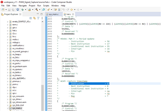

    In HALCoGen generated code, we have 58 instructions
    And the execution frequency for each instruction is 90Mhz, so the least LRP possible would be 58*(1/90Mhz) = 644nS.

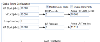

    You can just try below configuration:
    It will reduce the error at some extension.
    But if you want to further reduce it, then you should go for HET IDE, here you can generate a minimal code something like below:
    See here i just used 3 instructions, to measure duty cycle and period and duty cycle of waveform on pin30. As we have only 3 instructions, this would just require 33nS to execute. So in this case i just configured 88nS and executed and i got very accurate results.
    I am attaching my code for your reference.
    PWM_Signal_Capture (2).zip

    Is your temporary workaround is working for entire frequency range?
    It is the LR pre-scale parameter that you are changing. This makes the same change as the workaround we found. We found the solution without realising it :)
    Look this, we removed 7 bit shift right operation and we changed multiplication with 1422 to 11.1. This revision the same result as making the loop time 0. Look like:
    I totally get it. Thank you very much.
