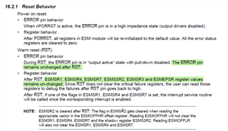

Hello sirs,
Could anyone help me with the following doubt ?
I have enabled the Reset in case in case of Oscillator fail and at the same time the NError ESM connection signal
My doubt is, which is the expected behavior in this situation ?
The nERROR signal will not be reached to be triggered due the reset? Or it will be keep in low state after reset?
