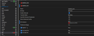

Important to mention here is that the two examples run on the two desired cores separately, however when I try to build/complie the combined multicore project, I get errors saying that there is resource conflict between the the two cores as shown in the snippet below:

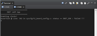

I tried to assign the other I2C instances for e.g. I2C_2 and I2C_3 also the MCU domain instances, this change enabled thge build to be successful but then at runtime the CPSW based app cannot read the MAC address from EEprom and I get the following assert failure:

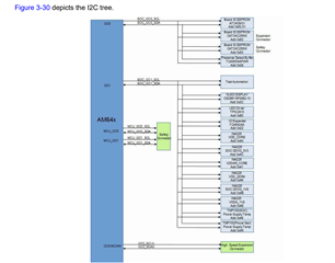

Also according to the user guide it can be intrepreted that I2C0 and I2C1 are the correct instances:/resized-image/__size/320x240/__key/communityserver-discussions-components-files/908/pastedimage1699372110278v1.png

    Secondly, the board EEPROM contains information such as the Board ID, MAC address etc. and is interfaced through I2C0. Since we allocate other I2C instances to CPSW, it is not able to get information from EEPROM.
    But there is one way to work around this step, that is to use a fixed hard-coded MAC address, rather than using I2C for reading it through EEPROM.
    When you build the application, you get a "generated" folder. This folder contains the auto-generated file based on the syscfg configurations made by you.
    Steps to enable hard-coded MAC address:
    1. Navigate to enet_lwip_cpsw/icssg example.
    2. Navigate to the generated folder (general path is enet_lwip_cpsw/am243x-evm/r5fss0-0_freertos/ti-arm-clang/generated
    3. Open the ti_enet_soc.c file and locate //#define ENET_MAC_ADDR_HACK (TRUE)
    4. Enable this macro, setting it to true,
    5. In the function "EnetSoc_getEFusedMacAddrs()" return the desired MAC address
    6. Recompile the project.
    Following the steps above should unblock you for now. You can try the above steps.

  • Hi Shaunak,
    The workaround with hard coded MAC address worked!
    However the original question remains, can two cores use I2C to read data from EEPROM or is it a limitation of the EVM board?
    So just to be sure that I have understood the constraint properly, It can be concluded that only one core can communicate with EEPROM, if the other core needs data from EEPROM then some other mechanisms are required.
    These mechanisms could be IPC or any other shared memory access?
    Kindly advise.
    Thanks and best regards,
    Shobhit
  • Hi Shobhit,
    I had an internal discussion with the team. Two cores might be able to use I2C0 to read data from EEPROM if I2C0 is handled correctly. This hasn't been internally tested so we haven't included a similar scenario in the SDK, but closing I2C driver on reading First MAC address in the EnetBoard_getMacAddrList function, and then opening I2C instance on 2nd core and reading data from EEPROM might resolve the issue.
    Again, this hasn't been fully tested.
    Secondly, you could have some IPC framework to share data from 1st core to 2nd core where 1st core reads the EEPROM data. I don't see any issue with that.
    Shaunak
