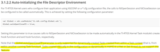

    • Is there a way to set Global.autoOpenCloseFD within the code or using syscfg?
    I'm not a TI-RTOS expert but after some searching, I find the below conditions for using autoOpenCloseFD. It says that autoOpenCloseFD is only supported for dynamically-created Tasks created from within a Task context (that is, from within another running Task function). Tasks created statically in the configuration or dynamically in main() or a Hwi or Swi thread do not support this feature.

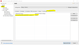

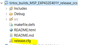

    • Alternatively, how do I get the .cfg being applied in a CCS project which did not have that file before?
    If you refer to a MSP432E example project like tcpecho_MSP_EXP432E401Y_tirtos_ccs, you will find that it has a dependency on another project called tirtos_builds_MSP_EXP432E401Y_release_ccs. The tirtos_builds_MSP_EXP432E401Y_release_ccs has the .cfg file.
  • Great idea, that project does have a cfg file indeed. Only issue now is that it does not find module ti.ndk.config.Global.

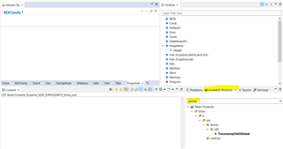

      I'm not an expert in MSP432E SDK. It seems that MSP432E SDK does not have module ti.ndk.config.Global. When I search 'Global' in the Available Products, I do not see the Global module.
    Unlike TI-RTOS for TM4C129 MCU, I could search for Global and it is there. I'm not sure if you had used TM4C129 in the past and was trying to find the equivalent module for MSP432E.

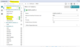

    I think the NDK is configured in the syscfg for MSP432E SDK.  If I bring up a MSP432E Ethernet example, I could see NDK and services being selected to support tcpecho application.
  • Hi Charles,
    NDK is perfectly working with other services indeed and yes, I did set it up via syscfg. There is also "Global", but all that is included on an application level which is why the setting in the tirtos upper project fails as this does not include any of these components.

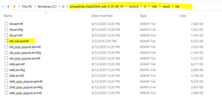

  • This is just my guess at the moment. I think DNS is part of the NAT package library which is not in your link library path. Can you add stk_nat.aem4f to your link library and see if that makes a difference. You might only have linked stk.aem4f right now.
  • Hi Charles,
    I have tried but adding NAT does not help. It also would have been surprising as we are not lacking DNS support but the problem is that the socket function called by DNSGetHostByName returns an error as autoOpenCloseFD is not active and there is no fdOpenSession in the SDK's function code.
