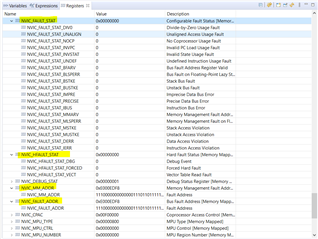

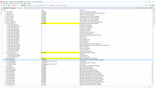

  • Hi Peter,
      What type of exception are you getting? What does the fault status register produce?
      All I can tell is that the processor encountered a Imprecise Bus fault. Normally, this is when the processor tried to write to an protected address or an invalid address (e.g an unimplemented address). Reads are precise and therefore you can use the fault address register to know what address caused the fault. Writes if at fault are imprecise because of the internal write buffering.
    Todd Mullanix presented some techniques to debug exception in this document. https://www.ti.com/content/dam/videos/external-videos/1/3816841626001/4910324181001.mp4/subassets/debugging-common-application-issues-ti-rtos-presentation-lab.pdf
    Here is another app note that provides some techniques to isolate the fault source.
    https://www.ti.com/lit/pdf/spma043
  • OK, I got it: it actually was a Display_printf line in the timer-callback function and the system crashed at the Hwi_disable of the clock_gettime only by accident because at that moment ti.sysbios.knl.Tak.IdleTask went into the above exception. Removed the Display_printf line from the timer callback and everything works fine. I did not investigate any further why I cannot use that command in a timer callback but as it is working now, I will leave it there.
