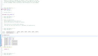

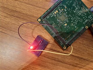

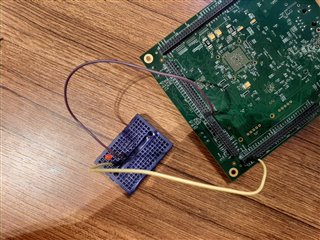

hello,
I am developing a project in IAR with tms507ls3137 processor.

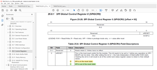

I need to control the MIBSPI5NENA pin as GIO. When I change the following code to spiREG3, I can control the spi3NENA pin, but I can't control the spi1NENA, spi2NENA, spi4NENA and spi5NENA pins.
following code:
spiREG5->GCR0 = 1U;
spiREG5->PC0 &= ~(1<<8);
spiREG5->PC1 |= (1<<8);
spiREG5->PC3 |= (1<<8);
spiREG5->PC8 |= (1<<8);
spiREG5->PC4 |= (1<<8);
