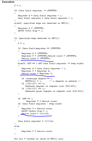

Assuming SWAG uses 10-2 teeth, falling edge is valid, at the end of the gear cycle to odd teeth after SWAG is synchronized, that is, the falling edge occurs and the period count of APCNT becomes 0 then the data fields of SCNT and ACNT for the next gear cycle are not incremented and remain at 0.
As described in the pseudo code in the manual, there are only 3 cases where the period count is assigned, as shown in the figure below, but the customer checks the EXC2 register and no flag is set at this time.
The following code is used, LR=128, HR=64, and HET1 generates a waveform on pin1. SWAG is also enabled after the software detects the odd dot teeth, and pin1 is connected to pin2 by hardware.

Here is a screenshot of the period count exception of APCNT that changes to 0 at the falling edge of the end of the odd-point-period, with the breakpoint set at the APCNT instruction:
