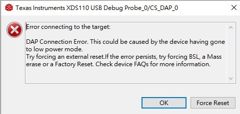

I am asking for my customer. They are using CCS 12.5.0.00007, and program the chip to their own board.
The device was successfully programmed for the first time, but the connection always fails at the second time.
We have tried to re-power the device after the Factory Reset, and the device can connect and program successfully again. But the next time programming would still fail.

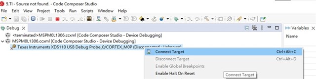

When we connect to Target device the error message show as below.
Has the expert seen such program issue ? Any way to solve this ?
