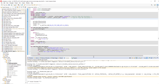

When I compile the demo for this processor, there are references in parity_functions.c to undefined test registers canREG1->TEST, mibspi1->PTESTEN, mibspi3->EDEN.  These are defined in the demos for other TMS570 processors and for RM42x,RM46x, RM48x. Do these registers exist in TMS570LC4357 or should these tests be excluded?

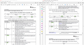

    They were included in TMS570LC4357 as well:
    Thanks & regards,
    Jagadish.

      Thank you for the quick response.  Your attached illustrations are a tiny graphic that is not readable.  Can you tell me the specific pages/sections  of the TRM or data sheet and the version number of your document?  Is there an update to the SAFE-TI zip file for TMS570LC4357  that provides the missing definitions?
    Darryl

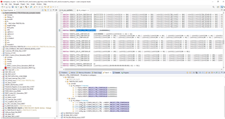

        Also missing, a whole set of definitions in HL_mibspi.h for MIBSPI1, that are defined for MIBSPI2,3,4,5, for example MIBSPI2_PAR_ECC_CTRL_CONFIGVALUE.  And in parity_functions.c there is no code for DCAN4_Parity, although there is for DCAN1,2,3. Thirdly, There is code for MIBSPI1_Parity and MINSPI3_Parity and MIBSPI5_Parity but not for MIBSPI2 and MIBSPI4.  If I have to modify the SafeTI code, that seems to defeat  the purpose of using a pre-defined Safe-TI library.
  • Hi Darryl,
    It is there, right? Look at below pic:
    I am unable to find them, can you please provide screenshots for better understanding.
    Thanks & regards,
    Jagdish.

    There are 3 issues, Two may be HALCoGen failure. I am using HALCoGen 4.07.01.  Missing register definitions in a structure, missing code in parity_functions.c, and missing assembly language code in HL_sys_core.asm
    #1. Missing register definitions
        It is difficult to provide screen shots of things that are missing.  Here are the errors
    Here is the definition from HALCoGen/TMS570LC43x/include/HL_reg_mibspi.h

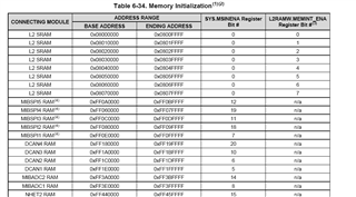

    #2 Missing MibSPI and DCAN4 functions--------------------
    In the TMS570LC43x path: C:\ti\Hercules\Hercules Safety MCU Demos\4.0.0\TMS570LC43x_target_sources\
    These three are present: MIBSPI1_Parity(), MIBSPI3_Parity(), MIBSPI5_Parity().
    parity_functions.c does not contain MIBSPI2_Parity(), MIBSPI4_Parity().
    These three are present: DCAN1_Parity(), DCAN2_Parity(), DCAN3_Parity().
    parity_functions.c does not contain DCAN4_Parity()

    When i build Safe-TI demo for TMS570LC4357 on my PC, i didn't see any of the errors you are talking about.
    You can see my build result. So, i don't understand why you are getting all those errors. Which version of safe-TI demo you are compiling? and did you made any changes to it?
    Thanks & regards,
    Jagadish.

  •     It is difficult to provide screen shots of things that are missing.  Here are the errors
    The PTESTEN and EDEN are two bit-fields of PAR_ECC_CTRL register. In HalCoGen code and SDL APIs, we define the register as a 32-bit register, and don't break it down to bit fields structure.

  • Do you know where I can find definitions for RAMTYPE_NHET2 | RAMTYPE_HET_TU2 | RAMTYPE_MIBADC1_RAM |
    RAMTYPE_MIBADC2_RAM  ?  These are specific to TMS570LC43x but not defined.
  • They are defined in sl_types.h
    The memory group numbers are defined in datasheet: Table 6-34. Memory Initialization
  • Sorry, I was using the wrong sl_types.h file from a different processor. Resolved now.
