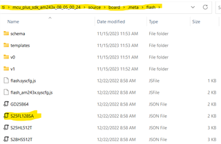

I have referred the SDK manual and got the article on how to add custom flash on to the LP. Based on that, I tried to change the flash parameters by referring the .json file available with the SDK but couldn't establish a successful communication with the flash device.
Basically, my requirement is to flash the bootloader available with the SDK to the MCU using uart uniflash. Then I should be able to load custom applications using CCS in QSPI mode.
I'm using CCS 12.1.0.00007  and mcu_plus_sdk_am243x_08_05_00_24. Could you please help me out with this issue?

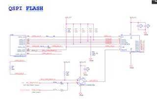

    The AM263x LP, which is with me, has S25FL128SAGNFI000 flash device. Please find the below screenshot from the LP Schematic. I've physically verified the part number on the board as well.
    I've populated this same flash device on AM243x LP.
    To change the flash parameters, I've used the JSON file for this flash device from the MCU SDK path.
    Since Load JSON option in Sysconfig was not working, I've manually replaced the corresponding values in Sysconfig by referring to this particular JSON file.

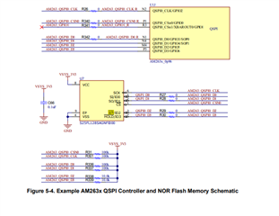

    The S25FL128SAGNFI000 device from AM263x requires pull up resistors for the HOLD and WP pins as highlighted in the AM263x Hardware Design Guide:
      Link to Hardware Design Guide: SPRABJ8B | TI.com
    I also realized that the LP schematic does not have these resistors in place like the control card schematic does:

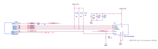

    Please follow the guidelines of the Hardware design guide, add resistors and try again. The AM243x LP has DNI resistor pads where you can solder 10K resistors on D3 and D2. Without these we cannot guarantee functionality
