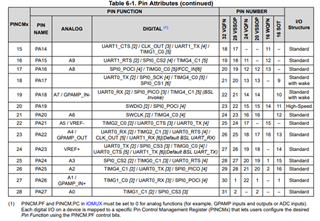

Hey Experts,
Could you please clarify which would be the correct pins for the Mspm0-BSL tx and rx.
In the datasheet we state to different pins. Pin 16+ "-" and Pin 1 + Pin 2.
Could you please clarify what would be the correct choice here ?
Is there a mistake in the datasheet or do I just missunderstand anything ?
Note:
When porting the bsl- example to MSPM0L11xx with 16WFQN package it also states PIN1 /& PIN2 as possible pins.
A further option would be Pin 18 which is as far as I can see not mentioned in the datasheet.
Thanks for clarification,
Alex
