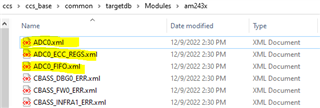

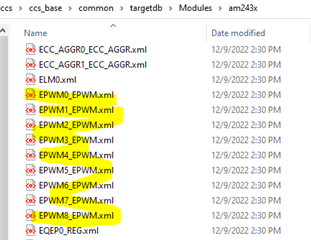

  • Hi Fabian,
    I am using CCS 12.4, and it displays the registers of ADC, ePWM as expected. Can you try he latest CCS?
    Please check if the peripherals xml files were installed to your ccs:
    C:\ti\ccsxxx\ccs\ccs_base\common\targetdb\Modules\am243x:

    I installed CCS 12.4, and now everything works fine.
    I checked the modules folder in the ccs10.4 folder and there were no xml files for the AM243x.
    The "AM2434_ALX.xml" file in the devices folder also doesn't link to anything.
