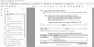

I have a doubt about my FreeRTOS application. I am running some tasks, and I sent a CAN command that activates a task with the reset instruction. The command came through perfectly, but the software did not reset. It seems as if it is stuck on this instruction.
                         sciSend(scilinREG, 7, (unsigned char *)"RESET\n\r");
                        systemREG1->SYSECR = (0x10) << 14;
I performed another reset, in an application without FreeRTOS and the instructions worked perfectly.
Maybe we need another instruction to reset the program if it is running with FreeRTOS?
