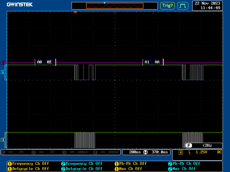

Dear all,
We are creating a new product using MSP432P401R with I2C connection.
I created the project with CCS and check the sample code from TI.
It can transmit I2C data successfully but error after receive I2C data.
The figures of I2C signal are shown below.

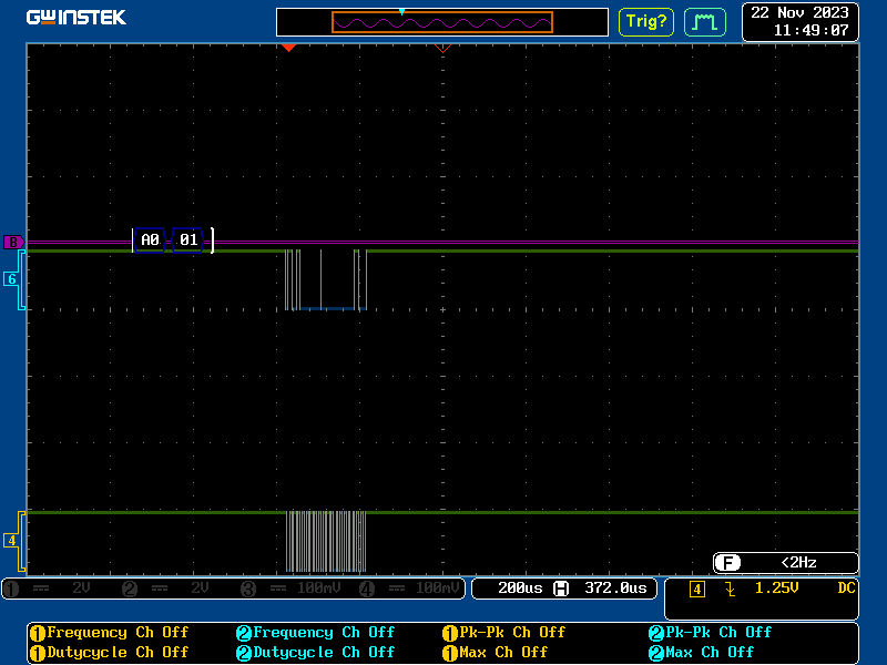

Transmit successfully
Fig.1 Transmit successfully
Fig.2 Receive successfully and the data is same as the data I saved
Fig.3 Transmit fail after receiving
The codes are shown below.
Each operation,I'll call I2C_Set() for assigning slave address then call I2C_Receive() or I2C_Transmit()

  • Hi Norton,
      A couple of comments.
     - MSP432P is an EOL'ed device that we no longer provide technical support on e2e. I can't review your code that is specific to MSP432P as I have no experience with the device. But I can provide some general feedback about I2C.
     - Your captures are really small. It is really hard to see. What do you mean the 2nd transmit does not work after receive? From your capture, it is sending something out. What is wrong with it? How is the 2nd transmit different to the first successful transmit?
      - I will suggest you make the 2nd transmit identical to the first one and single step your code to see if all the register settings are still the same between them.
      - There are several i2c examples in the SDK. Have you had a chance to run and reference them?
  • >  EUSCI_B0->CTLW1 |= EUSCI_B_CTLW1_ASTP_2; // Automatic stop generated
    > EUSCI_B0->TBCNT = Number; // number of bytes to be received
    UCASTP isn't cleared by UCSWRST, [Ref TRM (SLAU356I) Sec 26.3.1] so it will still be set (with TBCNT=1) when you do the subsequent transmit, and the Tx transaction will stop after 1 byte.
    I suggest you set UCASTP=0 in I2C_Set. Strictly speaking you should only change UCASTP/TBCNT while UCSWRST=1 [Ref TRM Tables 26-5/26-8] , but  from observed behavior I guess this isn't enforced.
  • Hi Charles,
    Thanks for your replying.
    I have found out where the problem is.
    It should transmit 3 bytes via I2C but it transmit only 2 bytes after I did the receive operation.
    The problem is the register "TBCNT" of EUSCI_B0.
    I enabled the interrupt in the receive operation but the TBCNT is not set to the correct number of transmit.
    It work successfully after I add the code to set the TBCNT register in the transmit operation.
