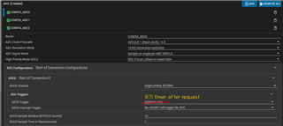

  • Hi Madhava!
    1. It is not changing, I have two different SOCs on one line. The first one is triggered by ePWM with constant frequency. The second (SOC 0, Hi priority) is triggered by RTI timmer by request, it does measurement 32 times and stops.
    2. ADCCLK prescalre 4, Sample Window 16. All measurements are performed in the scope of one ADC module.

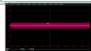

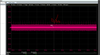

  • Hi Madhava!
    We did another test, and we observed peaks on the oscilloscope.

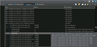

    Can you please describe your full ADC setup again? I don't think the numbers above make sense. To be clear, can you quote the exact ADC control register values applied?
    • What is the ADCCTL2.PRESCALE value?
    • What is the ADCSOC0CTL.ACQPS value?
    I read that as:
    • ADCCTL2.PRESCALE = 0x4. This results in a pre-scale ratio of 3 applied, resulting in ADC_CLK of 200 MHZ / 3 = 66 MHz
    • ADCSOC0CTL.ACQPS = 0x16. This results in a  sample and hold (t.sh) of 17 ADC_CLK cycles, or 85ns
    That setup results in too fast of a total conversion time. Checkout the AM263x TRM, 7.4.2.12 ADC Timings. And the table below (this will be in an updated TRM shortly).

  • Hi Randy!
    • Can you correlate the conversion results you are getting to oscilloscope measurements at the AM263x ADC pins?
    Yes, absolutely. I changed the frequency of sending command and I observed increased peaks appearing on the diagram.

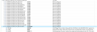

    It is 0x6
    it is 0xF  -> "it is 16 system clock cycles wide"
    ADCSOC0CTL.ACQPS
    Which commands are you referencing here? Is there a correlation between commands being sent on another interface and noise coupled to the ADC channels?
    It is our internal command
    By request, with a different frequency, at a short period. SOC trigger is the RTI timer.
    It is doing 32 measurements every 1.1 uS and stopped. I repeat this procedure with some frequency and observe peaks on oscilloscope.
    for example, DUT is measured every 25ms, and I observe peaks on the oscilloscope.

  • Hi Oleg,
    You wrote in hex format. I provide info in decsimal format. (the divider is 4 and the sample window is 16)
    OK - so that is:
    • ADCCTL2.PRESCALE = 0x6, or ADCLK/4
    • ADCSOC0CTL.ACQPS = 0xF, or 16 SYSCLK cycles
    Sets up a total conversion time of 285nS, which should be fine. I would still slow this down as much as possible based on the restricted bandwidth of your op-amp. Can you experiment with higher pre-scale factors and longer tSH windows?

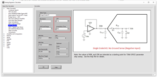

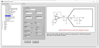

    Are each of those high pulses when the ADC is sampling? That looks like it might be some kind of transient effect caused by the SAR operation. Can you zoom in on those transient peaks and see what is going on with more detail?
    I implemented the equations referenced by https://www.ti.com/lit/an/spract6a/spract6a.pdf. For a 95nS tSH we need at least 38MHz BW amplifier. This matches with the implementation in the Analog Engineer's Calculator as well (https://www.ti.com/tool/ANALOG-ENGINEER-CALC). See the ADC SAR drive section. Insufficient bandwidth on the driving op-amp might account for the issue you are seeing.
    How are you driving the sense lines that are showing the correct conversion results?

    From my calculation it is (S+H) + (conversion time) --> (16 * 5ns) + (11.5 * (5ns * 4prescale)) --> (80ns) + (230ns) --> (310 ns)
    2. I am curious about, where you get the acquisition time (95ns) and  the Csh (15nF)
    Regards!

    • Some oscilloscope data was able to be captured in sync with one of the on-request, faster data – looked like it was hard to setup good trigger using the LeCroy viewer software to remotely control the scope
    • Looked like these scope shots followed the RTI ISR starting up for the ADC measurements
    • My conclusion: this is expected operations. I think we are just “zooming” in and out of the initial current ramp by setting different RTI ADC trigger periods. With the shorter 1.1uS, we are capturing the rising edge of current as the RTI interrupts start firing.
