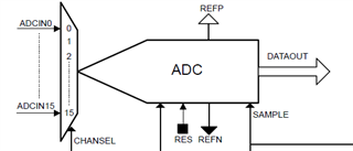

How quickly can the multiplexer connected to the ADC input be switched?

Hi Chi-san,
Thank you for the reply. I guess the information I would like to know can be on the datasheet, and I wasn't able to find it out. Are there no specific value of switching speed of internal multiplexer connected to ADC?
Shunsuke Yamamoto
Hi, Shunsuke
There is no related information in Datasheet.
But you can have a look at Figure 7-1 and 9-1 in M0L1306's TRM.
External Pin is directly connected to analog peripheral.
You can have the ADC and the digital peripheral share the same physical interface, which is not recommended.
Maybe I guess, the key point is the ADC start time.
There are some ADC switching characteristics in datasheet, such as Software trigger minimum width.
