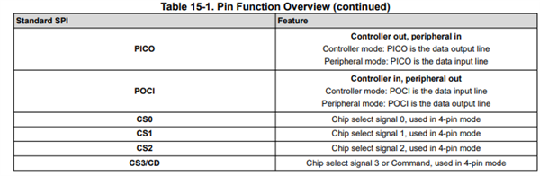

The limitation of this MCU to only have certain functions in a port is giving us a bit of headache, for example SPI ports are very strict and it seems that an SDI port can't be mapped to be SDO.
When the datasheet says: "SPI0 controller in/peripheral out"; does it mean that the MCU port is SDI and it should be connected to slave IC SDO?
