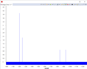

I'm testing the ADC with the LP-MSPM0L1306.
SDK : mspm0_sdk_1_20_01_06 (latest version)
Example project : adc12_single_conversion_vref_internal_LP_MSPM0L1306_nortos_ticlang.
I connected GND to the ADC pin on EVM and checked the ADC results in a graph.
As a result, the results sometimes have a noise.
The captured noise is small, with a typical noise deviation of +/-10.
However, sometimes the noise deviation is +/-100.
I'm going to capture this.
This test uses the settings from the example, so I believe it is the correct setting.
However this configuration of example showed noise.
Are there any guides or ADC settings on how I can reduce noise?
  • Hi SY,
    I think it relevant to the circuit noise for the high value. Meanwhile, can you change the sample time and check whether it is the same?

  • Hi Sal Ye,
    First, There is no voltage source noise. The input power is very stable.
    I got better results when I enable the hardware average mode.
    There is a lack of explanation for this feature. Could you explain in more detail?
    When this feature is enabled, will the result value be delayed for the accumulated time?
    How do I calculate the time the result value is accumulated?
